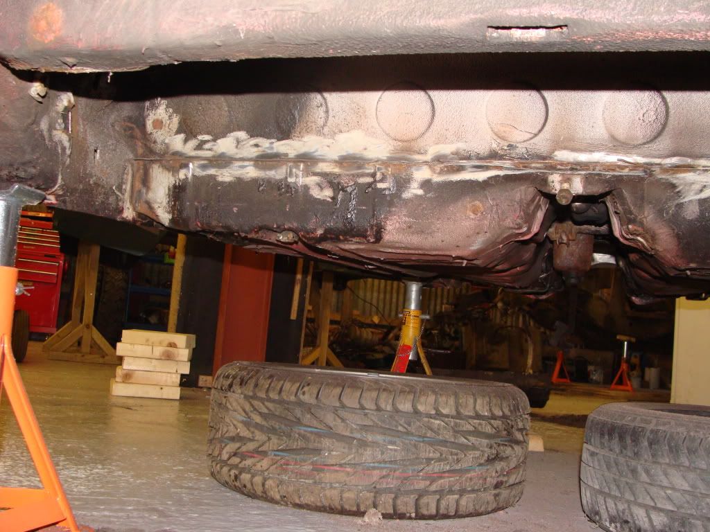

Few more progress pics:
Subframe stripped ready for crack testing:
Rear arches (making space):
Penetration from interior stich welding, requires all seam sealer to be cleaned and redone:
Fuel tank out to deal with more of the same:
Making space for bits:
Should be sealing and painting stuff this next week

Quote from: Yoof on October 17, 2010, 12:41:52 pm
Crikey what did you use to clean that up?
mine got about 2inches of gunk on it!
giorgio
Posts: 391
Re: Yoof's Turbo
Reply #95 on:
October 22, 2010, 05:09:10 pm »
Mark - Use fire/heatgun and is can be scraped off. Then wait (ages) for it to cool then rinse with p[etrol. Maybe a wire brush for good measures

Re: Yoof's Turbo
Reply #96 on:
October 22, 2010, 10:51:43 pm »
Mark- I used a good quality knot brush in a grinder, took a while but worth it. A clean with thinners afterwards, then POR-15 metal ready, then POR-15:
Alot of effort, but I doubt I'll have time in 5 years to be redoing it!
