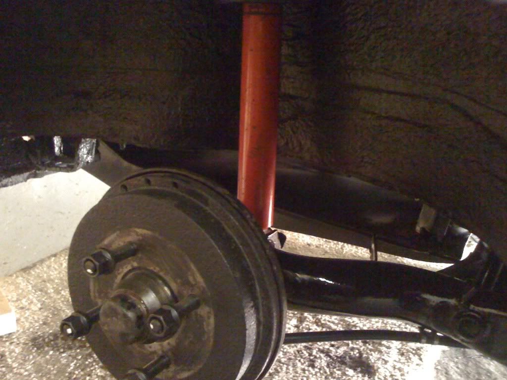

Rebuilt rear axle:
Built up with wheel studs:
