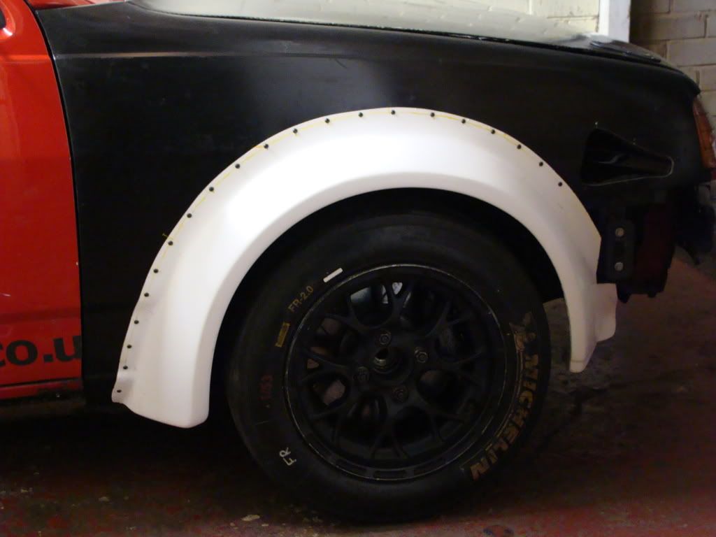

Not done anything on this for a while, but now I've moved house I've managed to finish off the ings, all bar indicator holes:
GRP Boot is here, so am going to pick the car up this Friday and trailer it down, I can work on it evenings and weekends then, should progress things a little quicker!

Miniman- Arches are from WL Motorsport in Germany, they're reasonable, but the fronts are about 3/4" different side to side in their dimensions, which is abit crap!

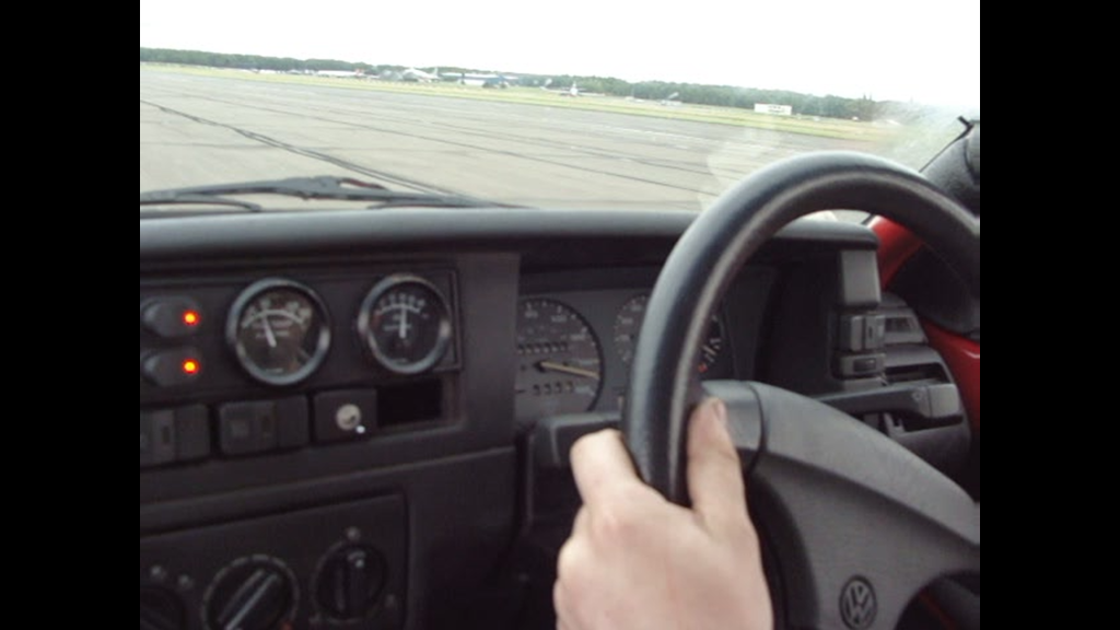

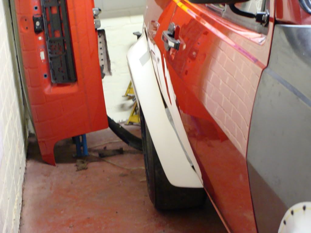

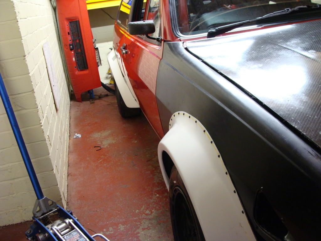

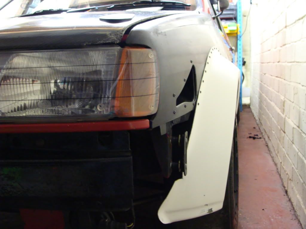

Wings are now mounted properly, quite happy with the fit, bonnet needs trimming and finishing, then onto the back and boot. Aiming to get it to the paint shot in a few weeks, so I can rebuild the box and start using it again for summer.
And 150mph:
 ;D
