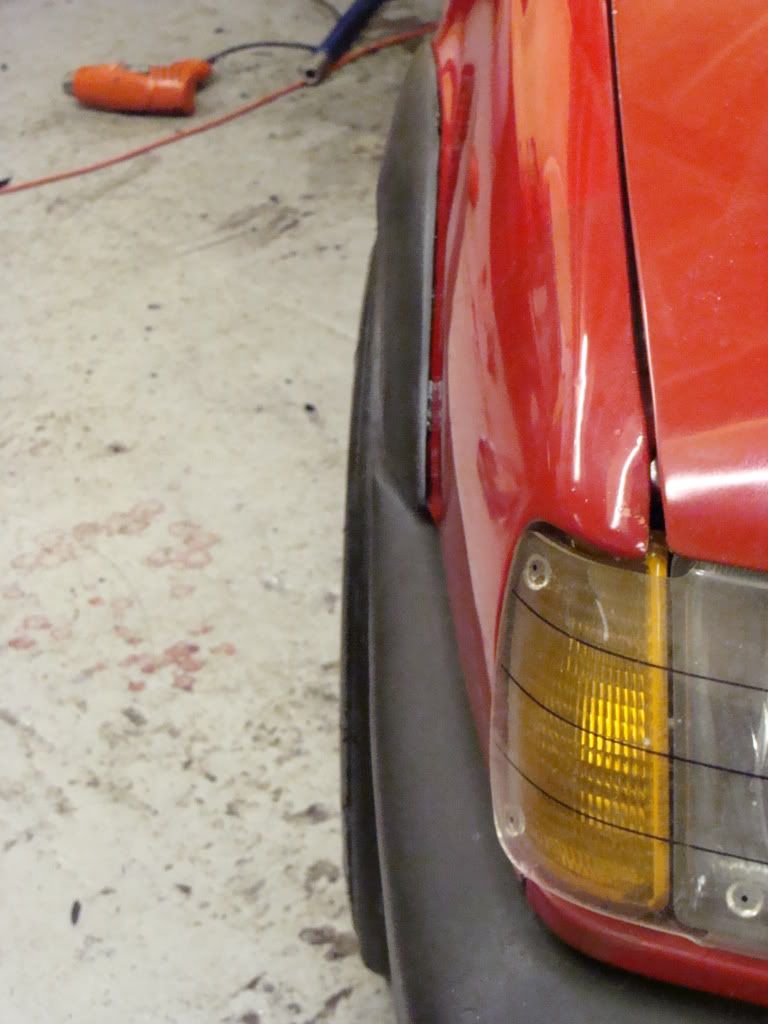

Hopefully I've fixed the wheel clearance issure, whilst keeping it looking stock  :)
Standard arch:
Fettled arch:
That's a few hours with a hot air gun and a length of steel to roll the plastic arch out, also did this to the bumper mount:
So that meets the 'stock' arch nicely again, still abit more to do.

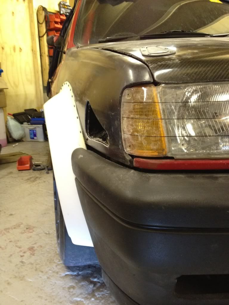

How the Polo is currently sitting, awaiting new panels:

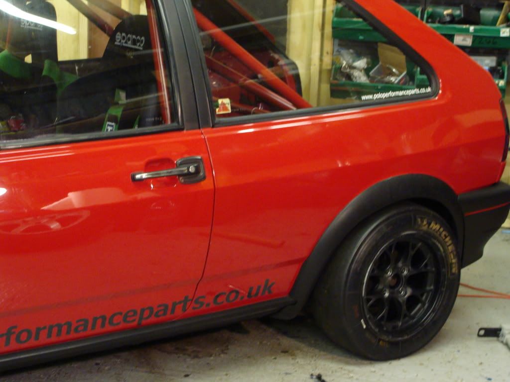

Recent progress:
Other side to do tomorrow
Front end is done now, just need to wait for the boot to arrive, and order rear windows.
I assume your colour coding them arch extensions? Also did you choose not to go back to the orginal wings and trims because of the amount of effort it took to fit them wheels under?
Might just go gloss black on the extensions, I'd want to colour code the bumpers if I did the arches.
The wheels would have been okay on the road, but scrubbed hard on track. So the berg arches give me alot more flexability regarding ride height, wheel/tyre combo  :)
Wings are now GRP as they're lighter, and I'd damaged the drivers side one in a 'racing incident' with Andy in his Saab 9000 a few years back!

Does that NACA duct on the wing go anywhere Yoof?
