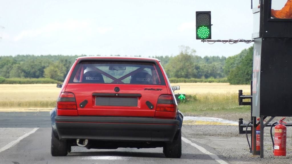

The leaning can be seen here:
So, my suspension setup is currently G40 Cup Car, a Sachs, fixed damper and standard 2.25" coilovers spring. A rate of 275lb front and 165lb rear. Unlike the Cup Car, I don't run a front ARB- I also have a wider track, larger slicks, and the front is probably heavier. So I've increased the front and rear rates fairly significantly, hoping that I can continue to use the current dampers I have. Failing that I'll look into modifying a Mk1 Golf coilover kit.

About the leaning, you are thinking in the direction of stiffer spring rates, but putting back the ARB is not an option? Could this be a shortcoming of the stage 3 subframe? Just interested in your thoughts.  ;)
About the gearbox conversion, earlier in the thread you mention that because of tilting the engine, you need to modify the oil pickup, the intake and the exhaust. Maby I missed it, but I didn't see anything about it in your thread anymore, did you go through with these modifications, of wasn't is neccesary anymore, or do you just don't want to make everything public about this modification?  ;D
Yes, I've already ordered stiffer springs  ;)
If the spring rate is correct, and the damper matched, an ARB has little relevance on track. For road use (not what the subframes are sold for  ;) ) this can cause an issue, as the pay off between ride comfort with a stiff enough spring to combat roll, on one which doesn't jar your back, is difficult to achieve. Andy has put significant time/effort into playing about with spring rates, ride heights, geometry and is now trying a fixed spring kit.
That said, we do have a 'stage 4' Frame, which allows a standard Polo ARB to be fitted, along with the normal compression struts. Wheel clearance will be an issue, and cost will be prohibitive for most- Andy will be testing this though once he's moved house.
