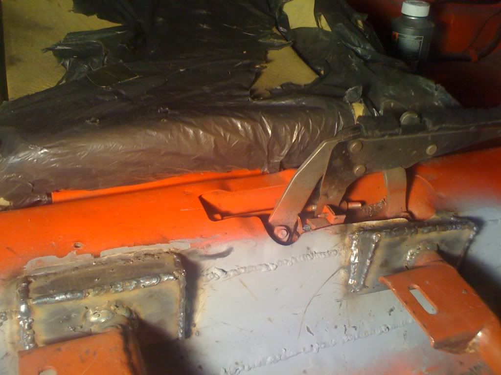

Carried on with putting my seat in, last thing to do before it goes off for a cage.
Made the mounts:
The rails where made from 28mm CDS with some 3mm metal bent round- the mounts are made from 3mm plate with 2mm sides.
Some tough bits, one of the hardest was welding a 3mm thick plate to a 0.5mm bit of body.
Et viola:
Took quite a while with jumping in/out the car, adjusting the height and position of the seat, eventually got it right.
Seat is actually 'Magnum- recaro copy?' but become race spec with a Sparco cushion to support my melon head :)
Going to book a trailer and hopefully should be going for a cage weekend after next :)

iv just finished installing the rear half of my SD cage myself! its not the easiest job welding thick plates to thin ass metal especially when iv only just learnt to weld  ;D
Yeah- one of the reasons I used 1.5mm plate on the seat rail area prior to welding the 3mm mounts in.

Looking good mate, seat runners look spot on there, bit better than my slightly bodged versions but hey they are there. Where you getting your cage done? Somewhere up your ends i guess...?
Chap who does the subframes for us, been doing cages for years too. Will take a while but should be top quality although MIG welded together he's really neat and it should be just as strong, still deciding what bars I want where etc.
