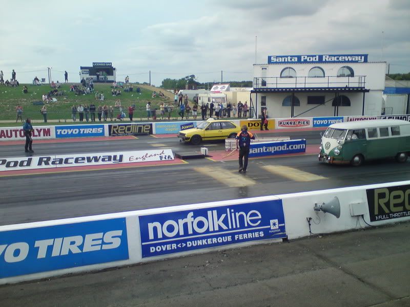

went to the pod this weekend for vw action, and decided to run the car up the strip. i said to everyone that i would blow the car up, and being a man of my word, i did =D on the 6th and last run of the day
some pics and a video from the weekend
a run against a plymouth pt cruiser haha
http://www.youtube.com/watch?v=Lp32UBV6YYI
best time was 16.7 out of 5 runs, worst was 17.1
got to have a lil drag race with bluey (liz's mk2 coupe GT too)
vids thanks to Gaz
