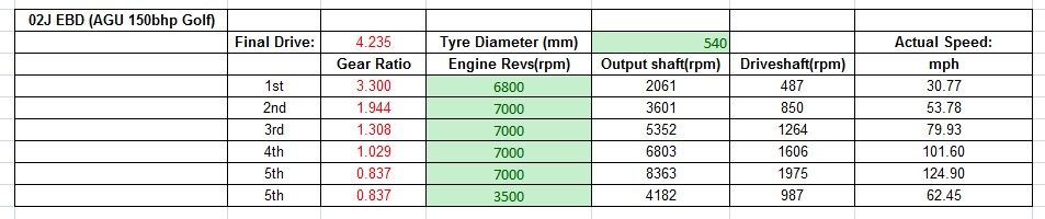

Stock G40 gives:
150bhp 20v 02J gives:
Not really ideal, similar to a GT box in terms of ratio spread.
180bhp 20v 02J gives:
Ratio spread with ATV on a 540mm tyre:
