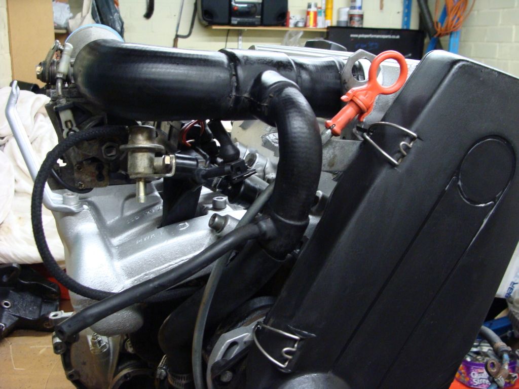

Been chipping away the last few evenings getting bits done and the engine dressed- few more bits to do, but not far off putting it back in the car now.
Pete will have rebuilt the lader so hopefully I'll drop the engine back in mid Feb, then MOT time  :)

Got new discs & pads now, along with a G40 airbox, so the list of parts to buy is small now.
Loom was next for some attention, a previous owner had done some interesting 'repairs' - no wonder it had a few running issues.
Loom started like this:
Removed the insulation tape from it  ::) :
That revealed some gems:
Luckily work have the correct connectors, so a few crimps later:
Bit of soldering:
Some heatshrink:
Job jobbed:
Had to do that on a few connectors- but loom is good now, all connectors cleaned too.
Wrapped in pukka loom tape and ready to go back in the car:

Over christmas started stripping supercharger at Pete's gaff, he's now finished it off so is fully rebuilt all new seals and bearings (unlike Jabba)
Pot of bits:
Finished article, same paint as the rocker cover, gearbox, and inlet - should hopefully look nice and clean in the engine bay  :)
Cheers Pete!
