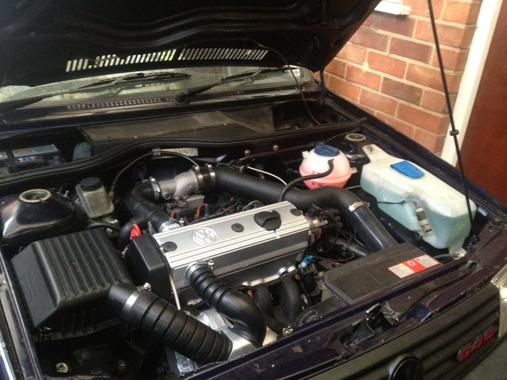

I used silicone in the end Taylor, fits well and means all the boost pipes are new and in silicone hose now, so no rubber to perish.
Almost ready to fire:

Last few new bits arrived, new lambda, gearbox oil, and a new alternator/starter wiring loom from VW.
Should be ready to fire on Monday  :)

Now running, tappets need to fill back with oil (take a few hundred miles) but all sounds sweet.
Needs a good clean now, then ready for it's new owner  :(
