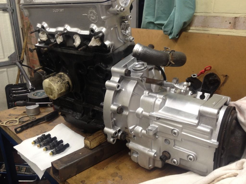

Been cracking on with this recentley, cleaning, painting, refurbishing bits and collecting parts, waiting for a top end gasket set to arrive, engine should be nice and fresh with a new cambelt and gaskets etc.
So, a few pics:
CG clutch release baring and clean gearbox (ATV):
CG Clutch (almost new):
Box bolted to engine so I can build it up before sticking it in.
Painting various bits with engine enamel- seems hardy stuff and looks great:
VHT on the exhaust manifold:
Refurbished Injectors ready to go:
REfurbished set of BBS from Pete- need a good clean but very straight  ;D
All for now, getting back towards an original smart (dare I say rare?) G40  :)
