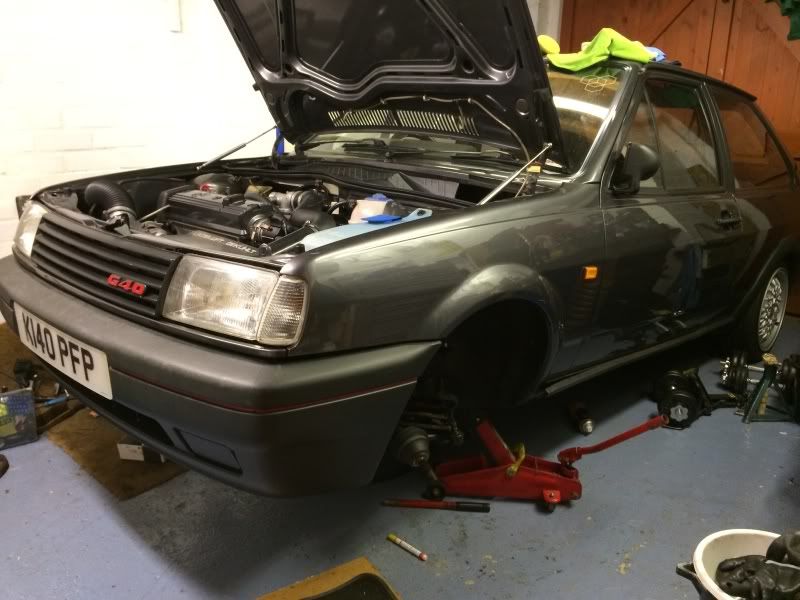

So I did some work over the weekend,
Saturday I stripped from the car -  Charger, Intercooler, Radiator, Plastics, Bumper, Front beam, Sump, Subframe, passenger driveshaft, alternator, and block pulley.
She now looks like this :( .. looks so empty
I also fit new sump with welded oil drain for turbo
Tonight I have fit the new engine mount, pulleys belt and alternator back on, nothing too exciting, I also fitted a blanking plug for the old oil drain for the charger.
I couldn't resist so I “test fit” manifold and turbo and downpipe to make sure it all fitted ok etc
