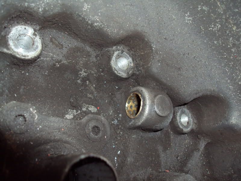

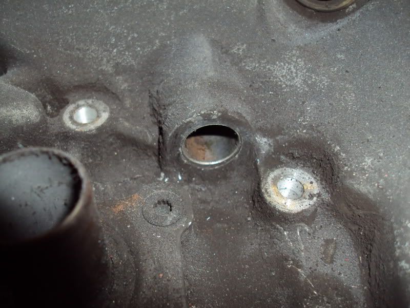

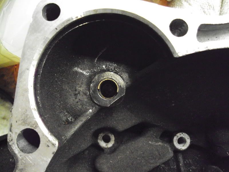

Nick_S
Bottom clutch arm bush
Top clutch arm bush
Starter Motor bush
Interesting thing with that starter bush is its from a 58k miles box and as the photo shows its slighty broken on one edge. The starter motor shaft on the car wasn't disengaging properly when fitted too.

as ive said ive replaced and adjusted numerous times its defo not the cable.  It's not the pedel box either as i changed this a while back when i thought it was that...and it made no difference. i got the pedel box out of a very low miles car.  when i said 'creaking' i was trying to describe the feeling more than noise...theres no noise from anything just feeling through the pedal.
Anyways Nick..cheers for the photos...so how do you get these bushes out? plus..is it a possibly its the arm?  Im thinking about the possibility of it being the splines of the 'lever' which slides onto the arm (parts 9 and 13) having wear on them and them 'slipping' if this is at all possible?
  that part you mentioned 7?  what exactly is this?
