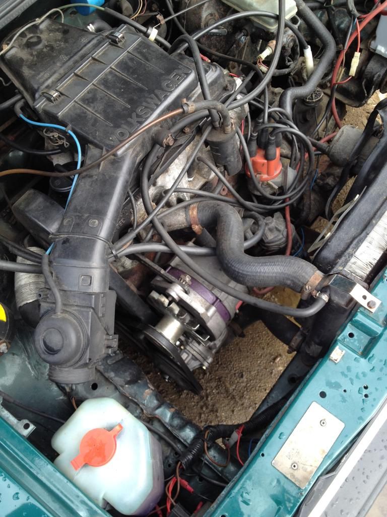

Hi guys, just wanted to throw some ideas your way, I have a mk1 golf, 1.5 jb 70 bhp carb engine and as fun as it is I'm after abit more and I'm going to do the bay this winter so it's the perfect opportunity, my only issue is I walk around the show fields and really fancy something different to whacking in an abf/g60/20vt etc etc, so that got my creative mind wandering, so I remembered reading winston's g40 carb turbo thread and really love the simplicity and left field nature of it.
soooo (I bet you can see where this is going ;) ) I took to the drawing board, my engine is 8:2:1 compression ratio and the g40 is 8:0:1 so not a million miles away! And there's a massive void in the bay...
all being well what I want to do is use a completely bog standard g40 charger (I'm keeping cost down and not chasing figures etc just want to be abit different) I can use the twin port vacuum canister (a la kjet turbo) on my dizzy for ignition advance/retard, use a r5 gt turbo carb, take advantage of then V belt setup that is already running my alternator and waterpump abit of custom fab work to mount it, custom pipe work/inter cooler etc and have some fun with a relatively inexpensive engine, I have another one that a friend is letting me have so I've not got much to lose. But I have a few questions regarding the g40 g-lader that I hope you guys can help me with
1. if I cannot get a r5 carb for a reasonable price I'm going to have to use a different carb, so I would need to know what psi the g40 puts out?
2. Oil feed, does the g40 need one or is it like the m45 "lifetime" oil setup?
3. If it does need an oil feed, I'm guessing I take it from the sum, but where do I return it?
4. How much should I be paying for a standard g40 charger?
5. Any size restrictions on intercoolers etc
6. What sort of increase would it make, so I can plan brake conversions etc?
7. thoughts?
Cheers guys
