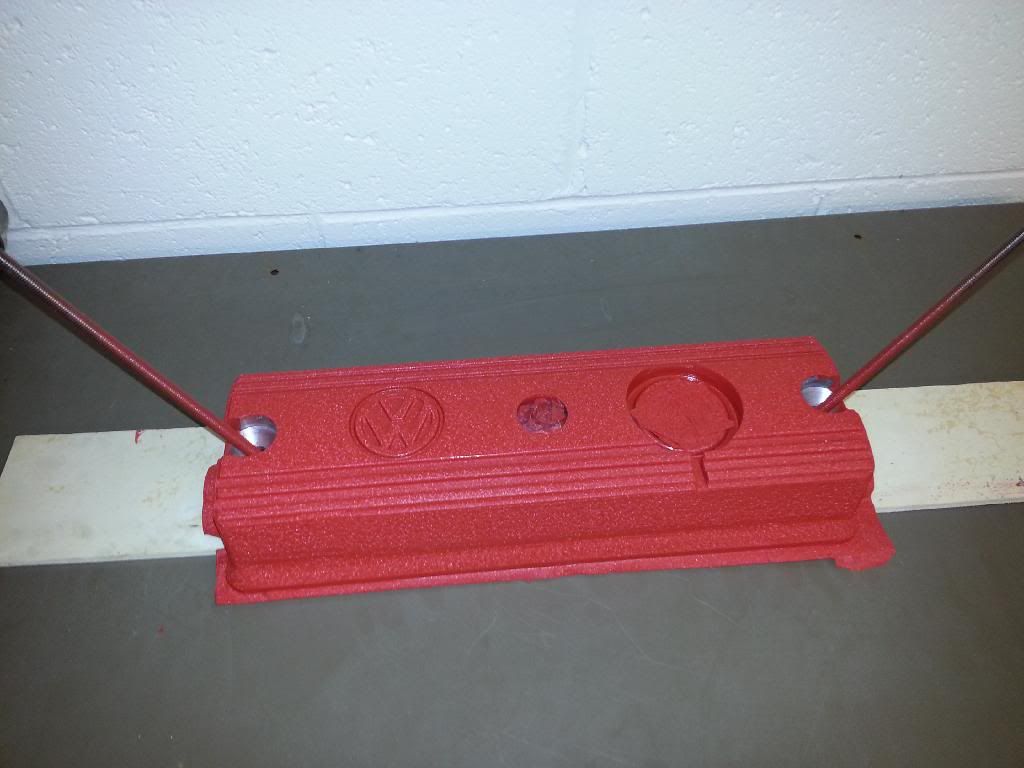

Started off with a standard G40 Rocker, now my car has had the return bypassed so the horrible inlet/outlet aint needed anymore, so I thought I would give it a bash at getting it blanked.
Start
After it being milled
polo g40 build by Matty!, on Flickr
The alu welded
After a quick whip over with a flapper wheel
Then after a hour or so of flapperwheeling!
So then I primered it and painted it Plastikote satin red...
When when dried looked more a lovley shade of Pink!!
So, I decided on VHT Crackle Red... which we on great, let it dry annddddd, it looks garbage, I put far too much paint on the top and not along the sides, the sides look awesome, the top is wrinklier than a 100 year old aborigines ball sack!
So I've sanded it back and painted again, fingers crossed it looks okay this time, havn't checked yet.

So after having to do this for the second time!!
I finally got a result with the wrinkle finish!
