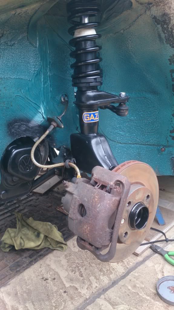

Gaz coilovers should be here soon :D excited, decided on a 250lb spring front with a tender spring, should provide a firm ride without being crashy, and i can adjust the rebound if its a bit harsh. should be hard enough for swiss mountain roads too

Aaaaannnnnd! COILOVERS ARRIVED!!!!! woop!!! they look frickin awesome!! so dam happy with them, fitted new top mounts, wheel bearings and hubs, i wanted to get the calipers refurbed but didnt have enough dosh, so got some used g40 calipers that i can send off when i get paid :)
