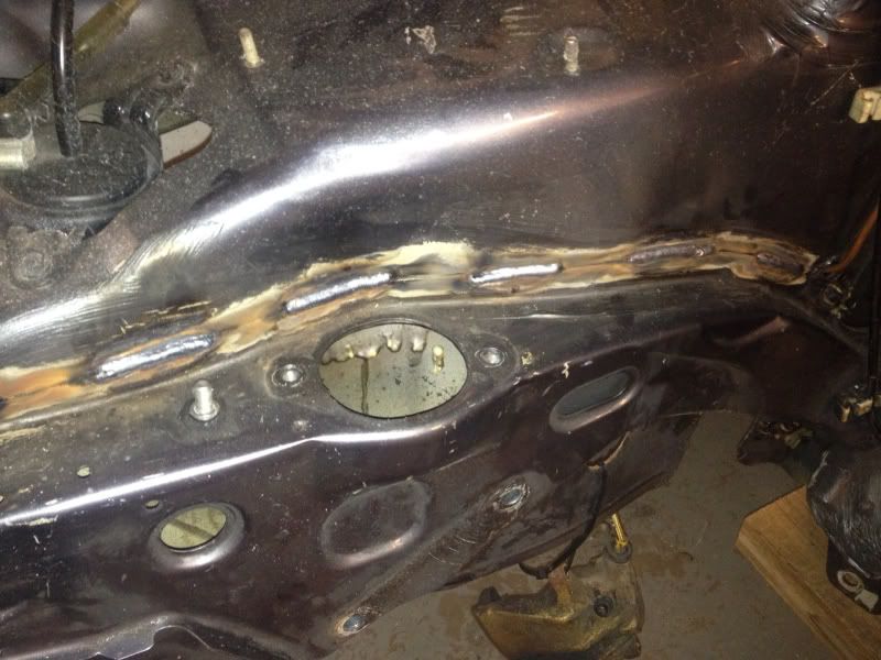

Although this car is a running a stage 3 ppp subframe it made sense whilst there is no engine in it to have the chassis legs welded and the general accepted strengthening mods done so with the help of some threads on here mainly the one started by Yoof the welding was done. I am lucky enough to have a guy who preps rally cars less than a mile from my house who really knows what he's doing with this sort of stuff so he is sorting the quaife and he did the welding for me. Chris has done a really good job on it all and put some hours in for me, big thanks to him.
