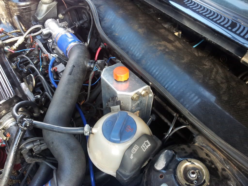

« Reply #11 on: January 31, 2013, 05:27:00 pm »
aquamist tank next to header tank...
