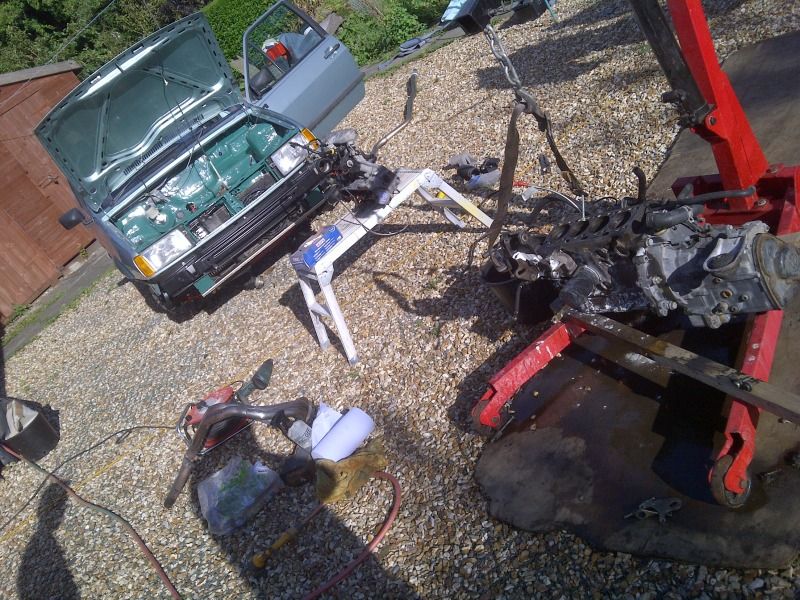

This is where it got interesting, i started the big strip down for the 16v and a general paint, thats it really.... things kinda spiraled, as they do....
I started stripping and removing things and causing havoc as i went:
After that episode i had to then consider fitting things back on! soooo, out came the thinking cap and a hammer.... :P

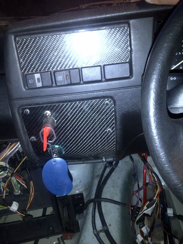

Now the heater was removed i had a huge void in the dash so both radio and heater areas got blanked with carbon sheet. Also in this pic is another of my issues, wiring!
Loom started off like this stripped, fixed the prone weak spots, extended when applicable and fitted roughly:
As things started to progress i added more and more to the centre console eventually having a much more practical dash space:
The dash panel bolts are now all gold anodised, a pic i shall get later in the week.
The large space next to battery cut off will be the fire extinguisher and kill switches i plan, not yet done.
