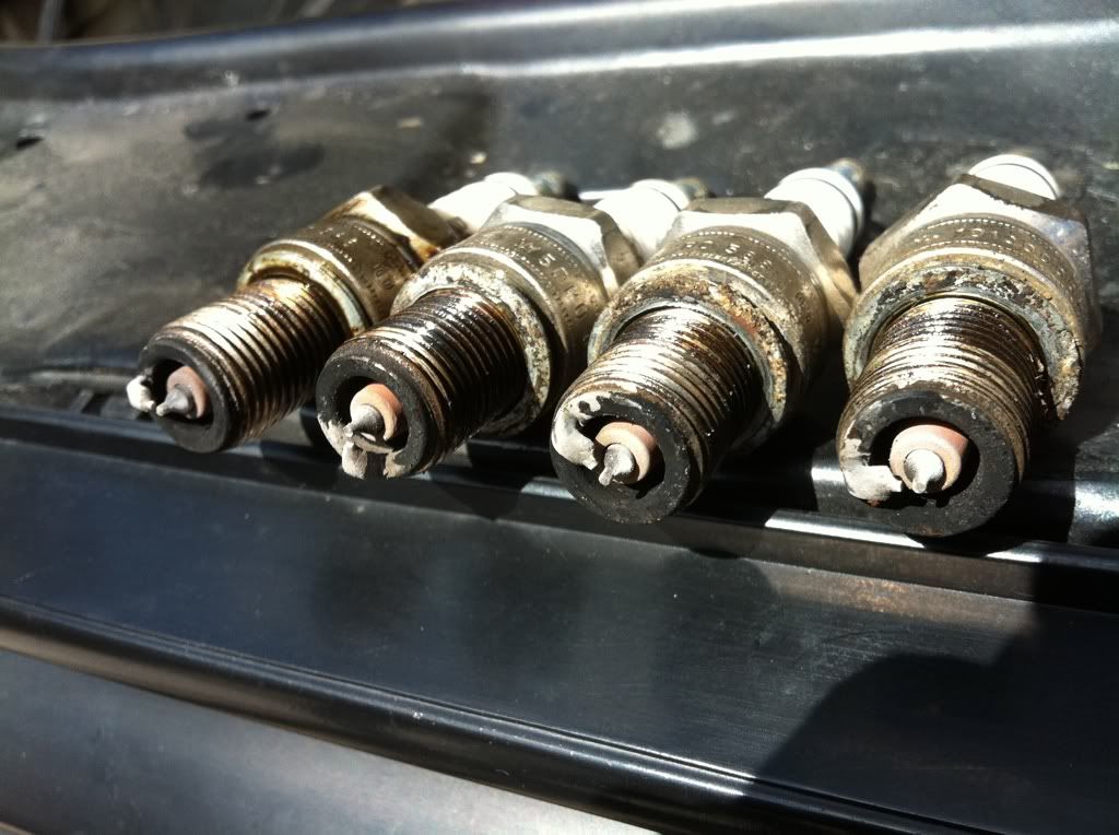

Did the test last night that I described above. All plugs came out equally heavily carbon fouled, no other unusual deposits or fouling.
I'd maybe put this down to it running very rich at startup, however, does this both with stock chip as well as the PPP one.

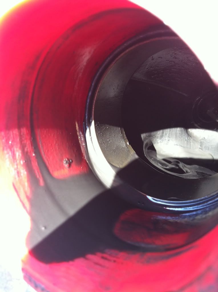

Had a look over it all this morning Took the boost pipe off to check how much oil is there and found
And most of the pipes and intercooler have a light greyish film of oil
I have genuine vw g40 spark plugs and they all looked the same

thats quite a bit of oil in the system! i'd say why your using it.  Probably a weaping charger oil seal.

yeah was a bit more than usuall, and noticed if i drive it off boost for 100+miles then use boost it blue smokes for a little bit then stops smoking so i quess this is all the oil thats getting stored in the intercooler and piping geting forced into the engine :(
