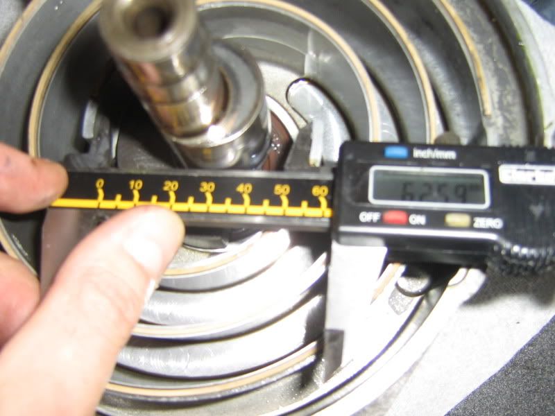

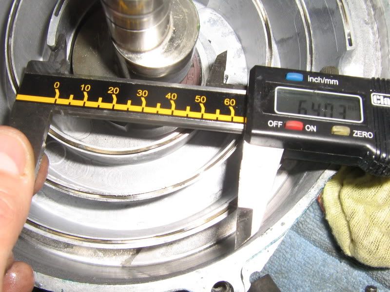

having had this problem with one lader
i'd suggest you measure carefully inside.  Below is a photo of two lader casings (both pulley side).  The top one one has had the scroll bearings fail and some impact on the charger walls, splaying out. the other, bottom one, is fine.  To the naked eye the first looks fine, but with a scroll in would not turn.  Took me ages to work this one out as its only 2mm, enough to cause a problem.  I replaced that side casing and the lader worked ok.
I've mixed/matched a number of g40 chargers (not the rare mk3gtg40 chargers) and never come across any incompatibility of parts - which can be the case with g60 chargers.
Hope this may help.  Feel free to pm me some measurements etc and i can compare if you dont have another lader apart.

Thanks Pete,
the charger/scroll contact does actually occour at the outlet end of the scroll, it is as if the scroll runs (rotates) 3-5mm futher forward (towards the outlet) than the markings on the casings.
