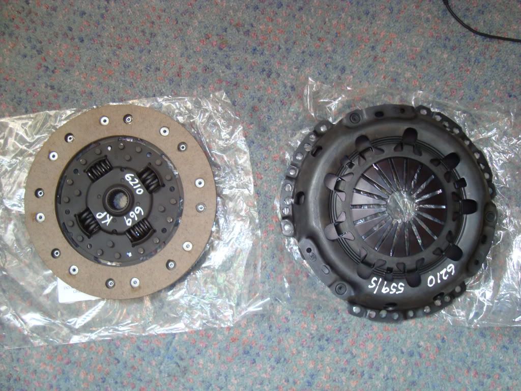

Even if thy just supplied you with a standard one then I don't see that it should slip with 150bhp realy, I do feel for you though mate it's not fun to keep having the gearbox on and off !!
from this:
http://www.polog40.co.uk/forum/index.php/topic,6435.msg46315.html#msg46315
it sounds like it's completely the wrong clutch you have.  Even a standard g40 one looks basically the same as that
dub-disaster
Did you measure the friction plate ? Maybe it's a 190mm clutch fro a normal polo ??
alexm866
think i may have a dud also, as the clutch i have received today looks totally different to the clutch pete is selling, i order the one described as being for "fast road use" i assume this is what pete is selling.
to Jezza: is this what it looked like?
also the one i have just checked it, and is 200mm
