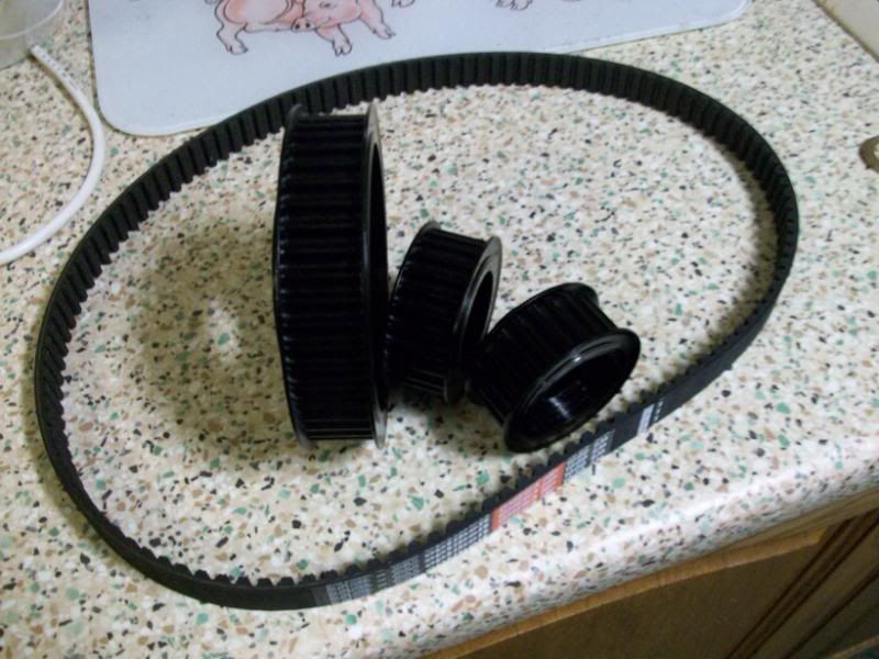

Conversion wise I had a little parcel today which was nice way to start the weekend. A set of 65mm toothed pullies I had been waiting for.
The engine spec going in will be -
stage 4 charger ( which needs new scroll seals before fitting)
Boost Return removed
65mm toothed pullies ( as seen above )
GT inlet
De-wedged TB ( not riveted - removed butterfly and chemical metalled )
Green injectors G60 ( just got them back from PP after ultrasonic cleaning )
G40 exhuast manifold with decat and G40 centre and backbox
induction kit
An old map to suit all the above.

are the toothed belts you got from Bar-Tek? im thinking of getting them,was it easy to get them shiped over?
JregGT
I don't think they are Bar-tek, I got them from PhilJ off clubpolo, he may well get them from them, but i'm unsure, it was just the easiest route for me. They are steel, so are reasonably heavy, compared to alloy PSD ones. But my bottom PSD pulley was ruined and needed to get my hands on a set. But I will certainly be keeping my eyes open for a cheeky alloy set!
Cheers folks
Rich  :)
