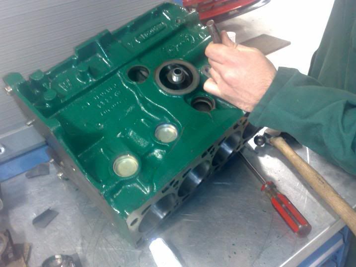

I took the high mileage melted piston lump out of the 40....
Bought some 77mm pistons...
Stipped it down to the bare bollox...
So after that I sent the block to be bored out 2mm, and to have the pistons, rods, crank, flywheel, clutch and bottom pulley off to be lightened and balanced...
Got it back
Freeeeesh
So I slapped some paint in the obligitory colour on
And waited patiently for my rebuld bits to come, went a bit anal, and got near enough every nut and bolt replaced, will do the same for the suspension.

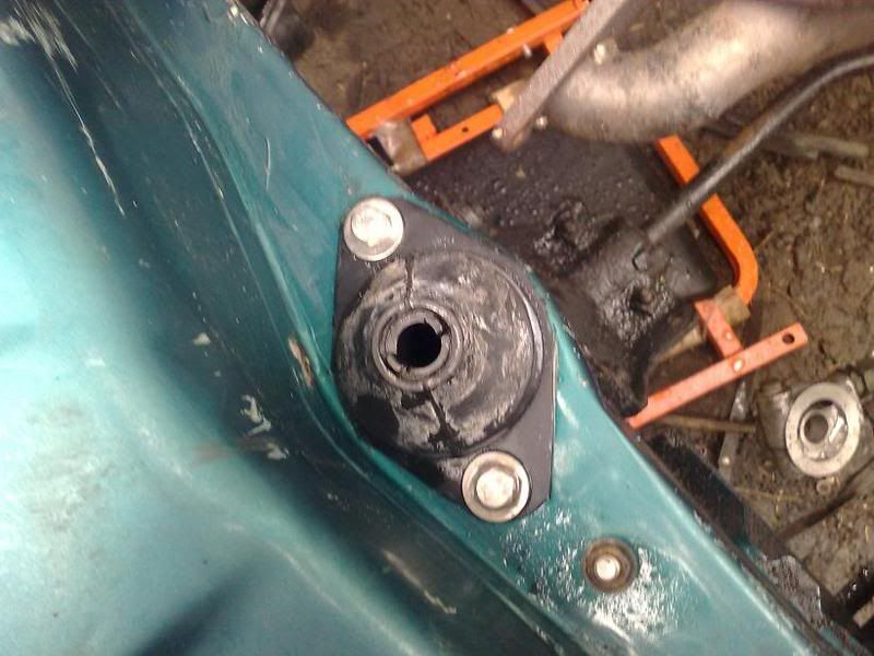

Got the new coilies out, went to put the salzmann top mounts on to find Gaz have used a different thread to the normal polo one. I've had and wanted the to use these coilies on something fresh for ages! Rather annoying. I had a set of cathedral clamps, but managed to loose one over the years...
So put the Fks back on for the moment so it can drive when the lumps in.

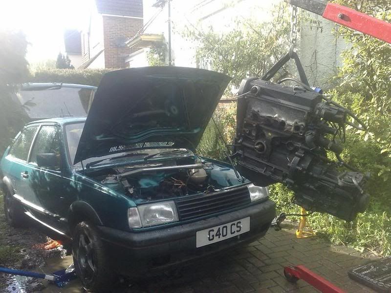

Then decided to crack on with the engine, so blagged a couple mates to crain it from the garage to the car.
Teased it for a bit.
Then chucked it in.
Fitted the rad as well..
The mess...
And its on the road.
Got it going, done 600miles so far, killed a headgasket in 15 miles, charger at 200, then a bolt for the rear gearbox mount spat itself out, then snapped a driveshaft....
