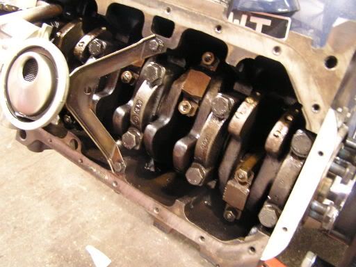

Anyways this went on I bought loads of new parts cleaned stuff up had things blasted, fitted new discs and pads, braided hoses had the charger rebuilt and oil feeds renewed etc etc and it looked like this

New update....I've done quite a few things to the car but ive been pretty quiet about it cos of work etc these include completly re wrapping the loom in genuine vag loom tape, a new bosch alternator, the usual regular oil/filter changes, new brake lines using genuine vag plastic coated steel lines, new brake compensator and new toyo proxes tyres.  However the time has come to start overhauling a few bigger more important things this summer...I use the car daily so after an initial rebuild a few years ago things are starting to wear so rather than just piss about ive decided to do them all pretty much to the highest standard that I can in the shortest time possible... all parts genuine vag items as always excapt discs and pads.  My list of stuff to do, some of which has been done before the point of writing this include:
head gasket (head bolts, waterpump, timing belt, thermostat housing, thermostat, exhaust manifold gasket, inlet gasket, manifold nuts) all been done
fuel filter also done
charger rebuild...done
bead blast charger bracket...done
callipers rebuilt, polmer coated black (biggred), carriers powder coated black to match, new calliper bolts, discs (brembo max), pads (Ferodo ds2500), handbrake cables, re-adjust/clean drums...to be done
New charger/intercooler boost pipe...to do
Vag exhaust back box, done.
Vag Radiator...to do.
Vag G40 bottom arms...not urgent but on the to do list anyways.
