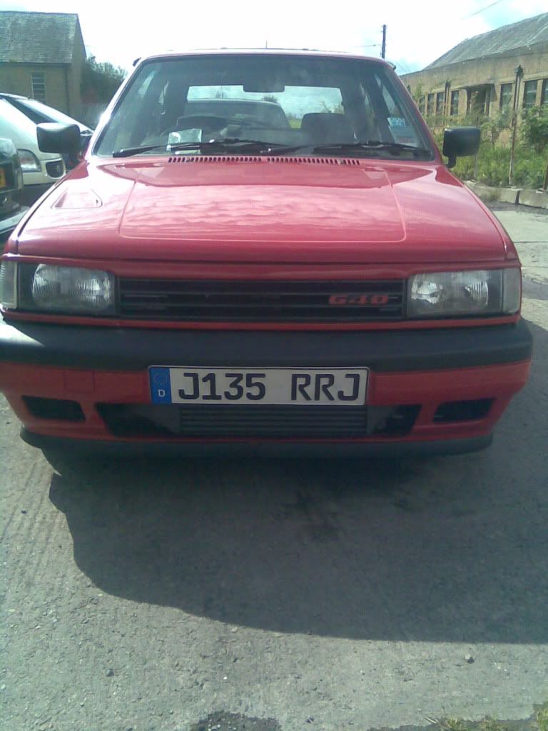

mine is mounted behind the bumper where the passenger side fog light would be.  It's bolted to the bumper iron using some brackets I made for it.  Then cut the front section of the bumper iron off so it's not in the way.
vwmk3jon
Not the greatest of pics (can get a better one if needed). Mounted at an angle in space behind foglight hole. Brought cooler from a MG spares place as it was cheap (£23.50 + postage!)
DMWG40
i took a few pictures when mine was loaded will try and load when i get home tonight
lance
looking at the picture its on the right hand side, not the left that is another rad for my turbo.
and then with bumper on
