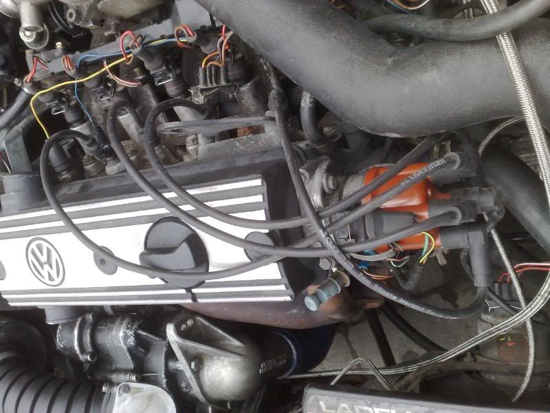

Is this the correct firing order for the HT lead setup?
She starts and idles but there is no exhaust so cant tell if she is running correct just double checking :)
cheers
andy
you've got one and four the wrong way round by the looks of it.  The order is 1-3-4-2.  1 goes on the forward-most connector and work anti-clockwise from there.
