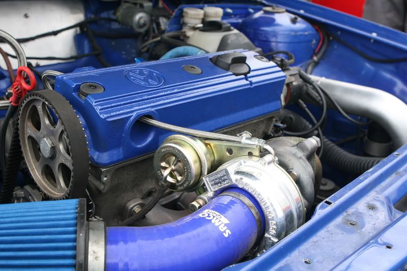

I remember from years ago somebody ( I think Steve Pitt AKA PSD / Beavis) had welded a 1.8t inlet plenum section to the G40 runners?
Trying to tidy my bay and am keen to find the pic, this is probably going back best part of a decade!
I presume he used a 1.8t Throttle body?
Any info well received.. think the car was blue?!

Yes he had the runners welded in a 1.8t plenum and he used a AGU TB.
The car had a standalone ecu and had no issues. If you want to use the 1.8t TB and the Digifant ecu you have to find a way to make the idle and wot switches operate correctly.

Steve's own pictures
