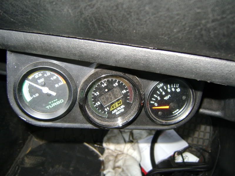

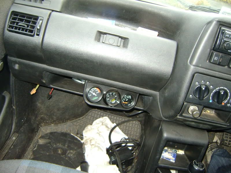

i'm with ihi rhb5 (0,8bar) and stock g40 injectors, stock fpr, stock camshaft and duty cycle is between 87-90% (remapped!)
Vizor- I'd replace them with a larger injector or increase the fuel pressure. I'd consider anything greater than 85% to be static.

I had another thought. ~ 240 cc injectors and FPR should be enough. We just do not see sense to raise their flow. In these data I am with 10.8 afr at the end of exhaust (However, there is more oxygen).
~240cc injectors and standard 3bar FPR should be ok with 0.8bar boost, although it obviously depends on the spec of the rest of the engine.  Increasing fuel pressure is certainly a common way of increasing fuel flow though, I've seen an eaton conversaion on a g40 engine where the "remap" consisted of nothing but increasing fuel pressure until an acceptable AFR was seen.  It ran like shite though but the conversion was full of bodges like that so the running issues could have been a number of things.
