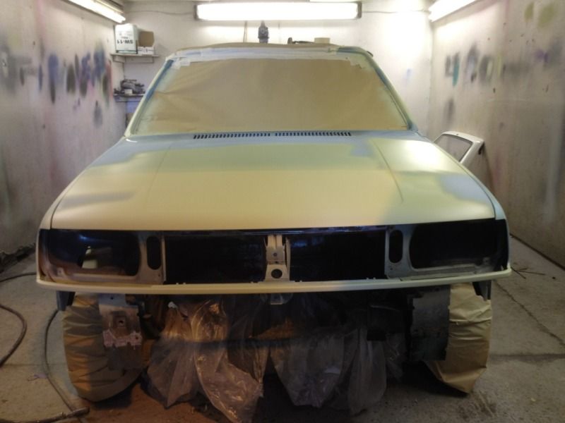

Masked up and had its first blow over of primer:
Next week it should be fully rubbed down and in primer ready for top coat.

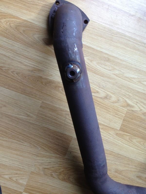

Time for another lambda boss in the downpipe. Unfortunately it's warped during welding, so waiting for an M18x1.5 tap and 16.5mm drill bit to arrive to sort it. Can't complain, a mate welded it for nowt.
Have never been happy with the old probe location as a probe there always seemed to read 0.5-1.0 AFR richer than at tailpipe. Meant for trouble come MOT time, so will see if this sorts it or whether it's a leak in the ancient Tube Torque pikey exhaust. Ultimately not too arsed as I'll be getting a custom downpipe made once it's back on the road to mate up to a shiny new PPP system I've got.

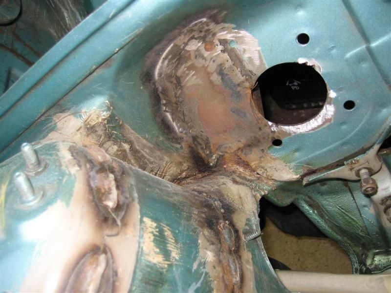

First up, the 'Yoof' chassis leg re-inforcement:

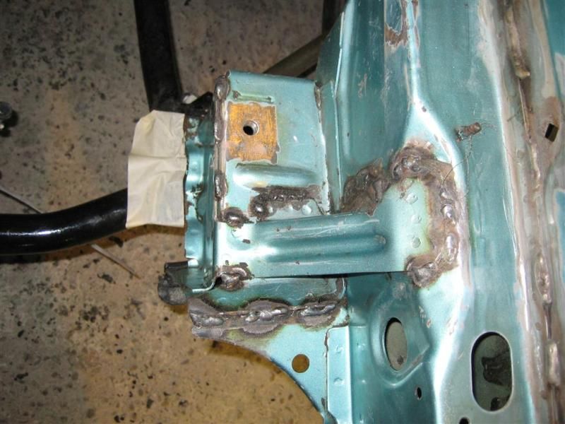

Secondly, the VW repair manual re-inforcement plates on the inner wings - can't hurt, and made sense while it was in bits:

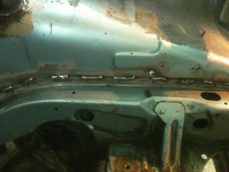

And finally, some stitch welding:
Few more pics from this Friday's trip to the bodyshop. Should be done by middle of next week! Pics of it in primer to follow.
Weld and filler, final bits of rust are fucked off:
Some higher resolution pics of the stitch welding and battery tray repairs, still in the process of being tidied up ready for primer. Metal used is plenty thick enough, so hopefully that battery tray will last at least another 20 years before deciding to rust to bits again!

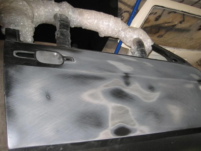

The only brand new panel that I bought, and although it's not rusty, it's dented to buggery. Not initially apparent from the satin primer, but looks like warehouse staff or the couriers have played football with it. Still, it'll only require very very minimal filling, but it's still annoying! The secondhand tailgate I bought is utterly mint though and ding free.

Sorted the lambda boss too. Time for the big shag drill bit and tap. Considering the bung that'd seized in there wouldn't shift I was expecting to be unable to resurrect the threads, but came out okay.
