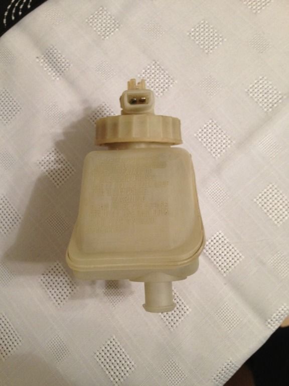

Dismantled the brake fluid reservoir and gave it a clean.
And clipped it back together. Have a 22mm master cylinder to plug it into, but ran out of time this evening to put all that together.
