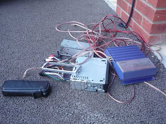

I now have no ICE in my car!
Never thought I'd actually do this, but faced with nowhere to fit gauges the head unit had to go, and that left the amp and wiring kit redundant. I've left the speakers and head unit loom behind, just in case, but this lot has all come out this afternoon:
