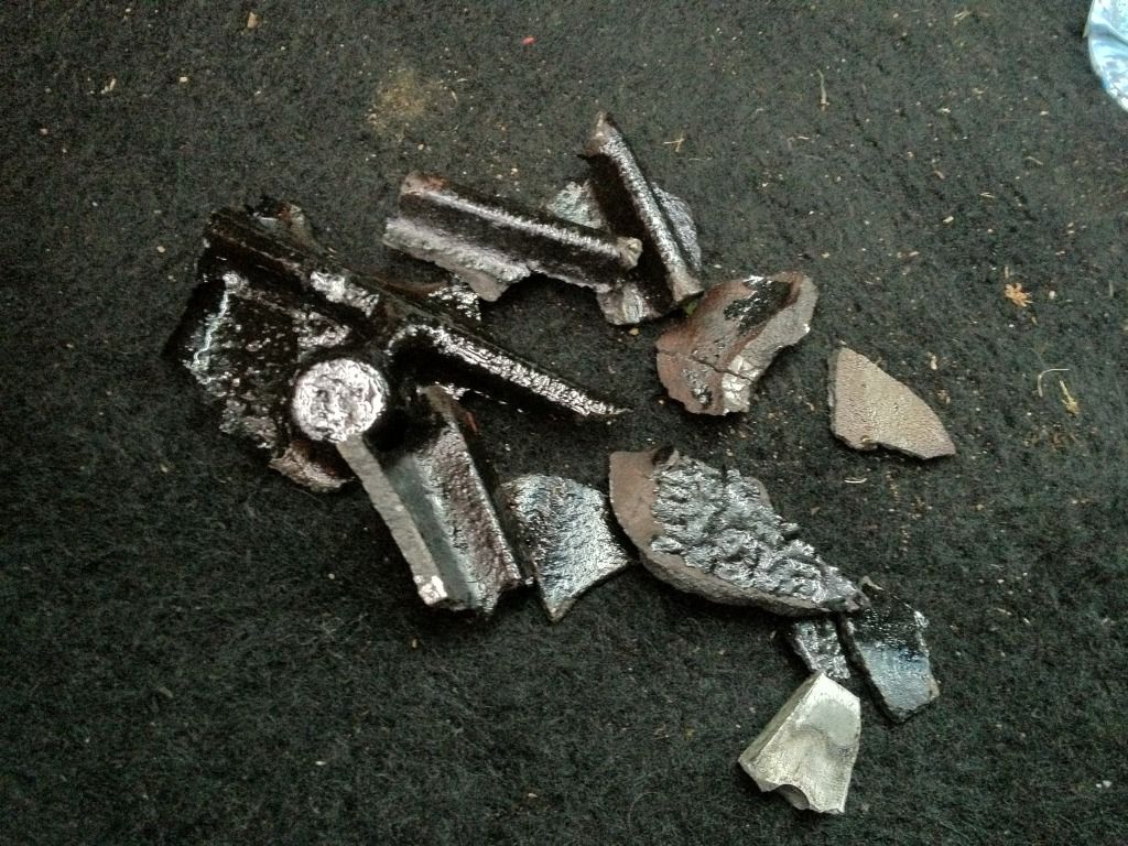

So, erm... I went to a PistonHeads meet yesterday evening, and erm, blew the bottom end up.
That's the block (or some of it) which was on the M6 Toll  :D
Unfortunately it also took the rad out:
So, some amusing pictures, it's gone through both sides of the block  :o (you can see the exhaust heatshield/clutch cable the other side!)
So, quick e-mail to TPS and a few phone calls later, picking another 1341cc BV head motor up this weekend, got these on the way to me too:
Complete with ARP bolts.
Need to strip down and inspect the engine to find root cause, hopefully the turbo and cam are still fine. So, it's engine back out time, again!

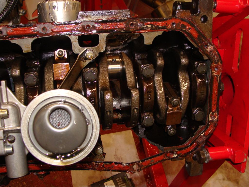

Was coming onto the M6, 3rd gear WOT about 4500rpm, stripped a little more down tonight, bent valves on No. 3 cylinder, and the piston is 100% mantle piece material now. Head will be repaired with a new set of guides/seats and two new valves.
I'm still not 100% convinced it was a rod bolt that let go first, no one can tell for sure but it seems to be the most probable root cause.
Sump is also dead so I need to weld a new fitting in another sump for the oil drain.
More gore pictures:
