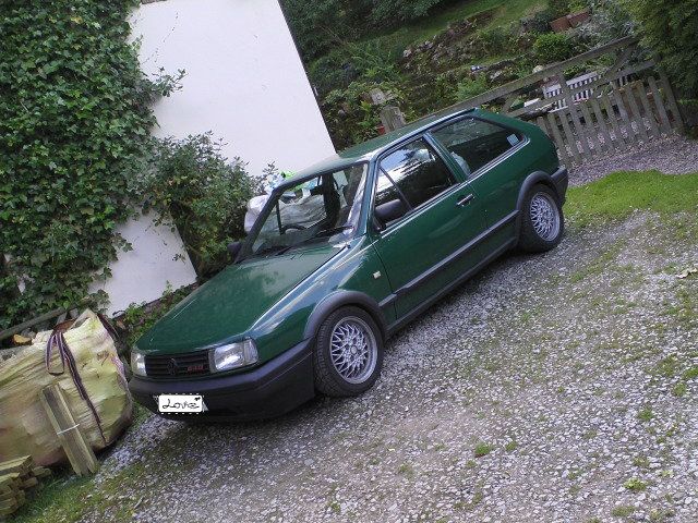

Had a g40 and sold it a year ago, ended up driving a mk1 tt for abit before someone writing it off 2 weeks after purchasing, saw my old G up for sale so went for it again and its good to be back.
I need better brakes, whats the best conversion for these?
Here she is

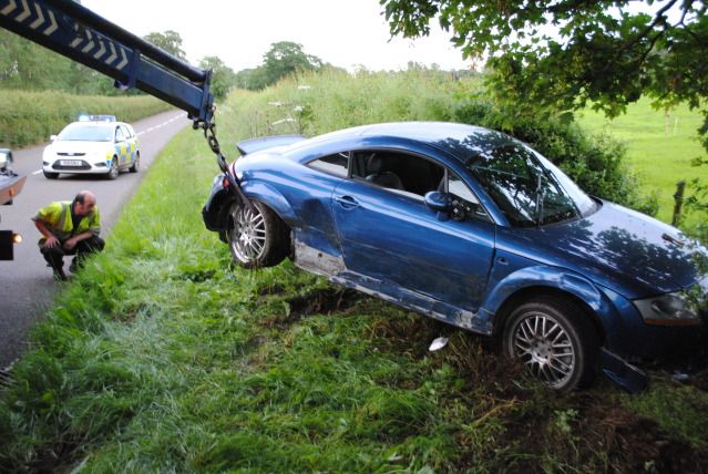

and my wreck
