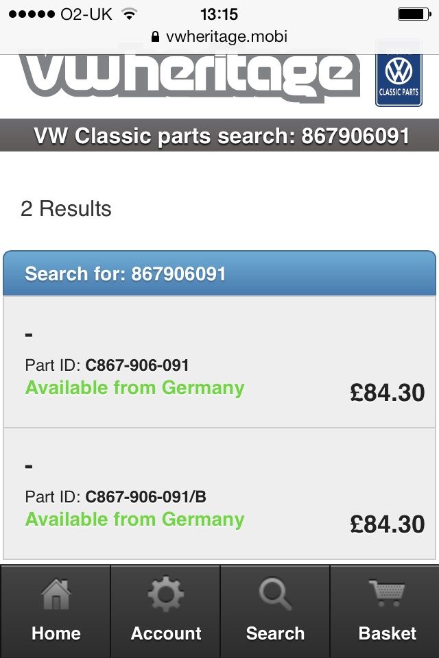

paulpolo
I think they're £76 posted from the actual vw classic parts site if you search for this: 867906091
http://shop.volkswagen-classic-parts.de/vwcp/kraftstoffpumpe-fuer-polo-86c-867906091.html
