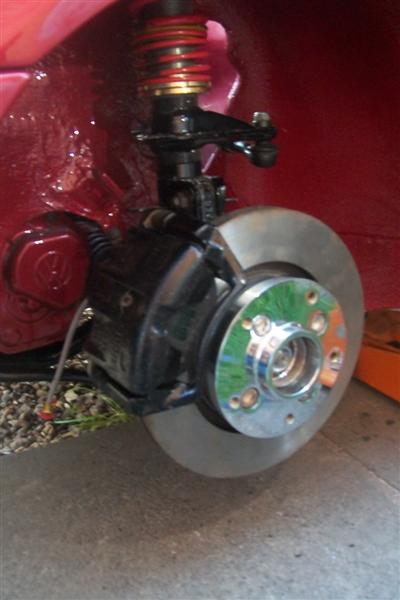

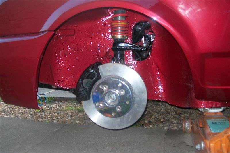

If you have the time and the patience - get mk1 struts and modify them - not the cheapest option but then again i have camber adjustment- unlike thos who have to use camber top mounts to get there wheels right.
if you want more pics, pm me and il try and dig them out

youngprodigys have you still got the build pics of when you adapted the mk1 golf coilovers?

« Reply #9 on: April 01, 2010, 11:19:40 pm »
I've got them somewhere. there's quite a few parts that you need to do the conversion. shocks with some polo shocks aswell for the arms, mk1 hubs, mk1 1.3cv's, and a few others. il try
and find them

youngprodigys - you say u can adjust the wheel camber? are polos known for bad camber/tyre wear when lowered?

« Reply #14 on: April 06, 2010, 05:05:44 pm »
if im correct then if you slam a mk1-3 polo the camber on the front is awful and the tyres will wear out, thats why people have the camber ajustable top mounts to try and reduce this. i wanted mine to look quite stock so i incorporated the mk1 hub and shock so i could do this and get the wheels flat on the floor - not on the pi$$ which will help handling.
and the reason why??? well with a 180+hp front wheel drive polo it will handle like shit so its just so i can put it on the floor at shows lol - if i wasnt running big wheels then i could get the drive shafts touching the chassis if i wanted to
 ;D
