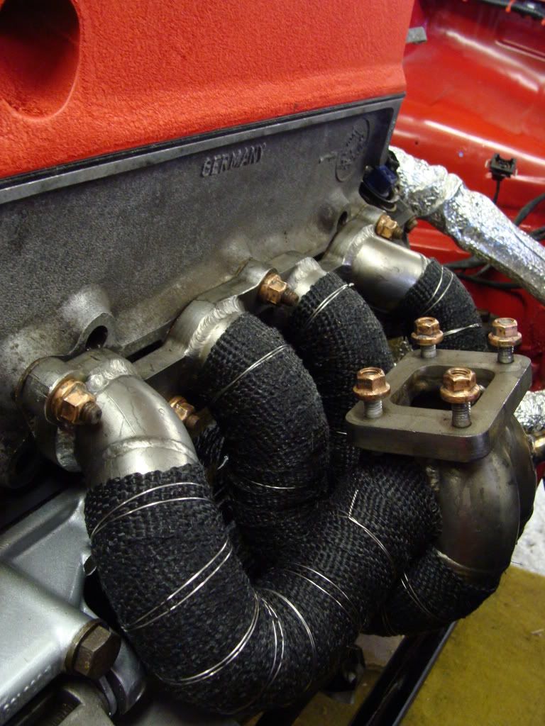

Progress, turbo mocked up:
I removed the manifold and had a fitting welded on for EGT, and then heat wrapped it, I'd originally planned to ceramic coat it, but at nearly £300 for a manifold and downpipe I decided against it.

I love it! The level of detail in this build is what I most enjoy - like the EGT sensor expert positioning and the manifold heat wrap, the black (I hope it stays black!) looks fantastic and the little twists of wire holding it all together really set it off. Superb!

looks great, you should get a turbo blanket too for more insulation.

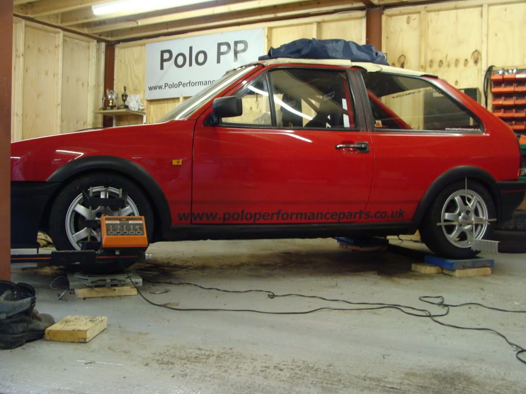

-2.5' Camber both sides- not road friendly!
