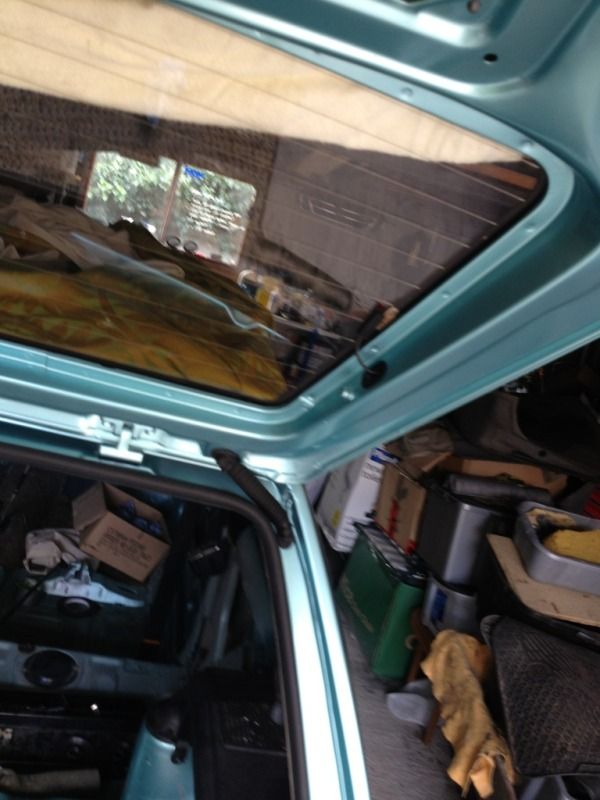

Wiring harness now back in the tailgate - I'd de-pinned the connector at the vehicle harness end which is about the only way I can see you getting this harness in and out unscathed. Anyway, it went in okay and routed nicely:
New washer hose added and threaded through. This was more of a pain in the arse than the wiring harness, but got there in the end.
Wiper motor back in and wiring all clipped up properly - also Waxoiled the fuck out of the inside of the tailgate too, as I didn't want a repeat of what happened to the original.
