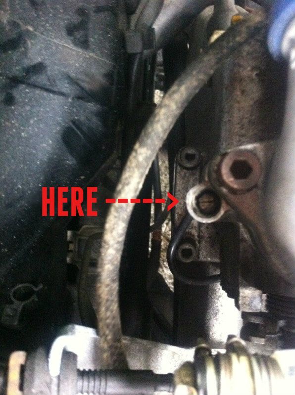

Took starter motor out and used some good old up leads to test it and it worked fine.
Put it back in and it now turns over but very slow, so took the plugs out and she turns over a lot better, after refitting the plugs its back to being really slow!!
Going to hook her up to my Golf tonight and see if its any better, i cant see what else it could be other then a low battery. Engine is earthed fine and an all cabling seems good.
Fingers crossed it kicks into life tonight as i soo want to hear it run.
Plus side i must have good compression if it slows the turn over down when the plugs are fitted :)

often down to bad earths or the big cable from the battery to the starter.  Or it could be as simple as a dying battery.  Have you got a charger or at least a battery tester you could use?

Was just a dying battery!
Hooked it upto my golf and left it for a few minutes to get some life into it, turned over a few times then started to pop... Left it a little longer then tried again and it roared into live!
