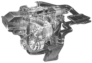

Although unique to the G40 model, the G40 engine (code PY) is closely based on the standard 1272cc Polo power plant. This conventional 4 cylinder water cooled design uses a cast iron block and alloy head. In the G40 it is transversely mounted, coupled to a manual 5 speed gearbox via an uprated clutch. Its main difference from other Polo engines is the addition of a supercharger to significantly boost power output.
![](images/g40engine.gif)
